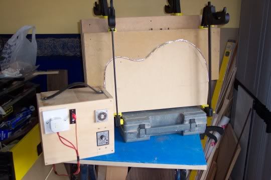

[QUOTE=charliewood] I have given my mandomaniac {Tom Durr} heatblanket with thermostat a few test runs - it works perfect!
It goes up to your pre-set temperature, then about 10degrees above then falls to about 10 degrees below, then 8 above 8 below 6 above/below until it finds the perfect temp! It was expensive at $325 USD but I got the quick connects and timer with it for that price.
so I can interchange blankets of any size quickly and easily.
I may have gotten one cheaper but for a newb like me being able to set the temp and timer is priceless - monitoring it would probably have been stressful for an inexperienced guy like me.
Good luck finding the right one for you.
cheers
Charliewood[/QUOTE]
I got plans from Tom. And built the unit with parts from E Bay. works like a charm.240v
   Mark

Matt--The PID, as you probably know, is really simply to connect between the blanket and the power source. I do use a solid state relay between the PID and the blanket as the PID can't handle the load.
Nelson
